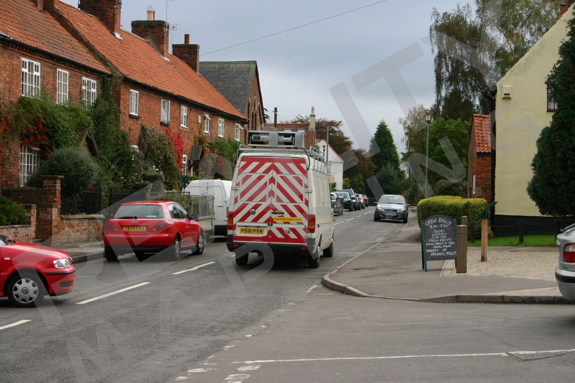

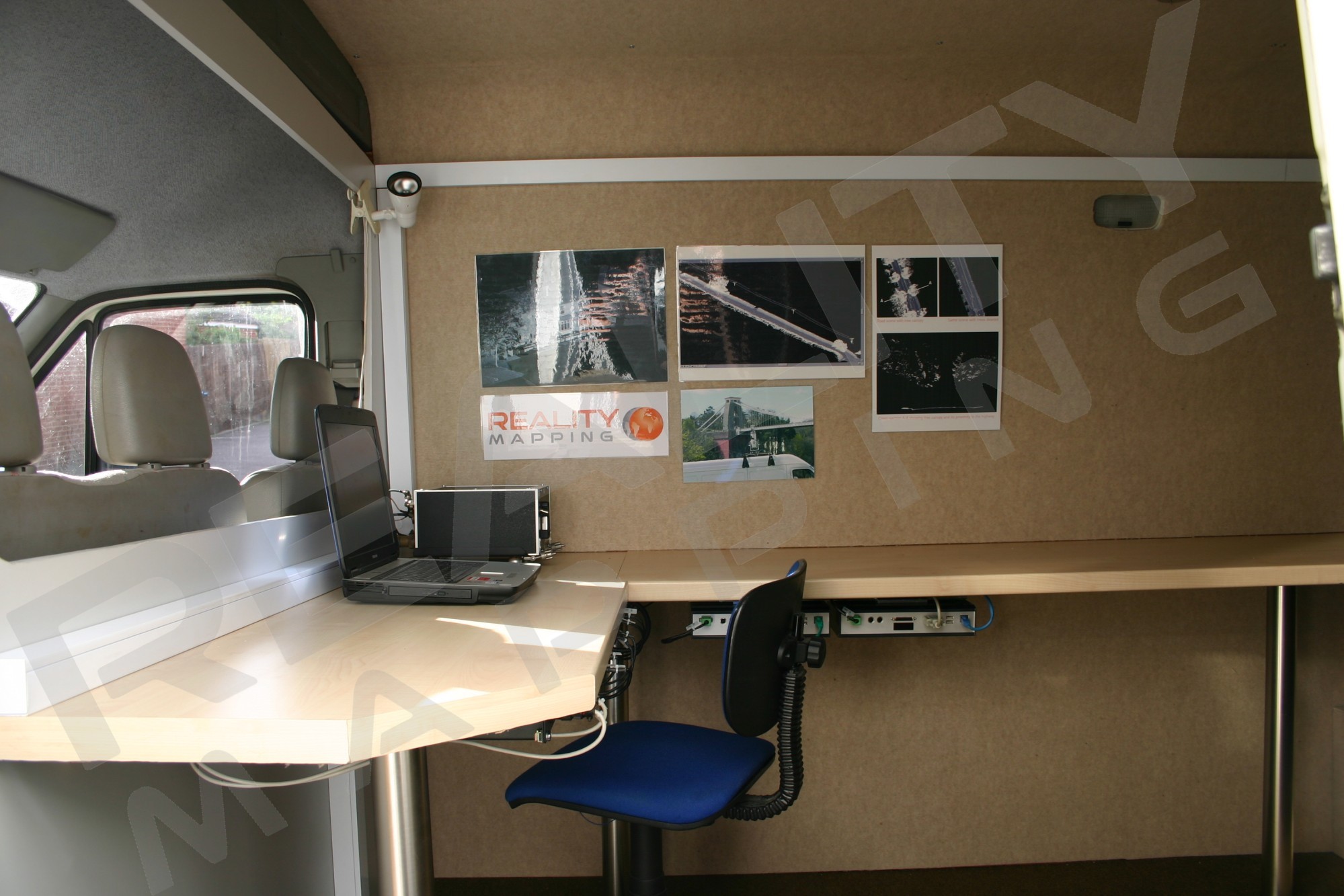

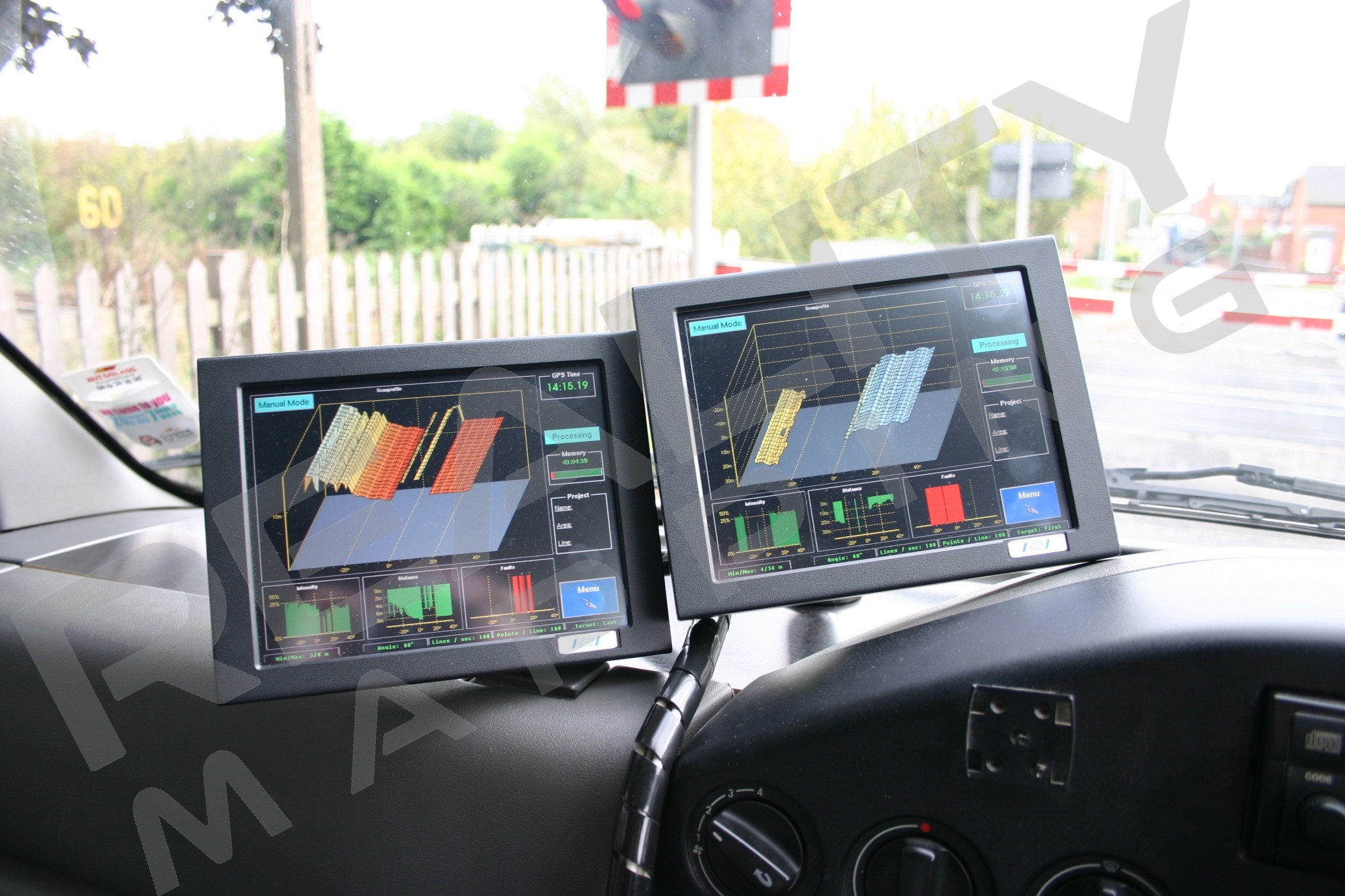

The StreetMapper system comprises a roof-rack mounted laser scanner platform and a rack-mount PC/instrumentation cabinet. A custom-designed power supply and operator workstation is provided for each system depending on the survey vehicle. The system is extremely versatile and can be deployed on various vehicles:
  • Typical van (usually with a high roof)
  • 4x4 vehicle
  • Quad bike (larger models)
  • Boat
  • Train

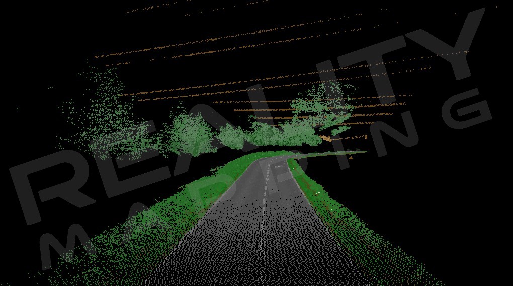

The StreetMapper survey vehicle uses well-proven laser scanning technology to capture the position of up to 16,000 3D points per second whilst in motion. The typical positional accuracy is better than 1m and the point-to-point accuracy within the data is 3cm.
Deliverables
An inherent feature of LiDAR data is that it is acquired, processed and delivered in a digital format, making it very easy to work with and to create data products that meet a wide range of needs. The system is easy to mobilise and immediately after the survey the data is processed to provide point data with XYZ position and reflective intensity. Depending upon the customer’s requirements, the data can be processed and analysed further:
  • Classification of laser data (for example ground, vegetation, buildings, wires)
  • Vectorisation of laser data
  • Measurement of features
  • 3D modelling and texturing
